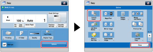

1.
Press [Copy].
2.
Press [Options] → [Print & Check] → [Close].
3.
Press (Start).
