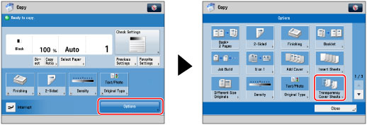

1.
Press [Copy].
2.
Press [Options] → [Transparency Cover Sheets].
3.
Select whether to print on the inserted sheets → press [OK].
To set the size for the transparencies to output, press [Change] for <Transp. Size> → select the transparency size → press [OK].
To specify the size for the inserted sheets, press [Change] for <Cover Sheet Sz> → select the sheet insertion size → press [OK].
4.
Press [Close].
