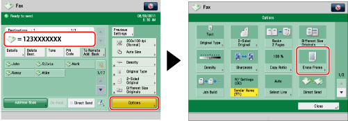

Press [Fax].
2.
Specify the destination → press [Options] → [Erase Frame].
