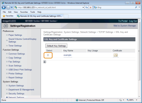

5
Select the check box of a key to specify from a list of keys and certificates.
Click an icon for keys (or certificates), you can check and verify detailed information of certificates.

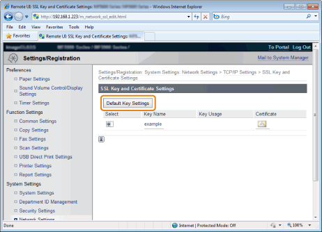

6
Click [Default Key Settings].
7
