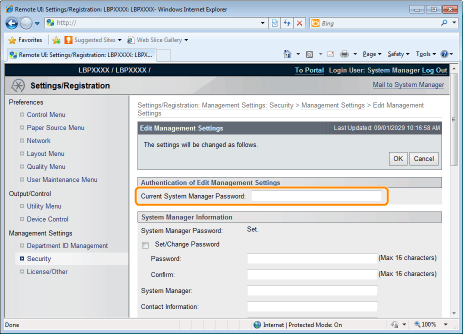

5
Enter the current password in [Current System Manager Password].
6
Set a new administrator password.
(1)
Select the [Set/Change Password] check box.
(2)
Enter the administrator password.
(3)
Click [OK].
Select the check box when setting/changing the password.
[Password]
Enter a new desired password.
[Confirm]
To confirm the password, enter the password entered in [Password] again.
