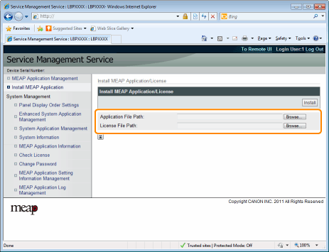

3
Set [Application File Path] and [License File Path].
Either select the file by clicking [Browse...], or enter the location where the file is stored.
Specify a file with a "jar" extension.
[License File Path]
Specify a file with a "lic" extension.
