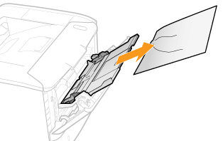

Referring to the procedure on the display, follow the steps below to remove jammed documents.
1
Press [  ].
2
Remove the paper by pulling it gently.
If you cannot remove the paper easily, do not try to remove it forcefully but perform a procedure for another area which is displayed in a message.
