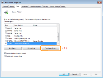

10
If you want to use LPD, change the port configuration information.
When using LPD printing, set up the LPR protocol using the procedure below.
(1)
Click [Configure Port].
(2)
Select [LPR].
(3)
Enter "lp" in [Queue Name].
(4)
Click [OK].
