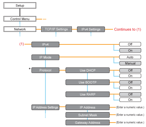

To set the IP address using the printer's control panel, use the following menu hierarchies.
[Protocol] is displayed when [IP Mode] is set to [Auto].
Pressing [ ] (Settings) displays the common Setup menu.
indicates that the procedure is performed by pressing [ ] or [  ] on the control panel.
indicates that the procedure is performed by pressing [OK] on the control panel.

1
Press [  ] (Settings), select [Network] using [  ] and [  ], and then press [OK].
When the message is displayed, press [OK].
You can specify the settings when the printer is either online (the Online indicator is on) or offline (the Online indicator is off).
2
Select [TCP/IP Settings] using [  ] and [  ], and then press [OK].
3
Select [IPv4 Settings] using [  ] and [  ], and then press [OK].
4
Set it to use [IPv4].
(1)
After selecting [IPv4] using [  ] or [ ], press [OK].
(2)
After selecting [On] using [  ] or [ ], press [OK].
5
Select the method for setting the IP address.
(1):
Select [IP Mode] using [ ] and [  ], and then press [OK].
(2):
Select a method for setting the IP address using [ ] and [  ], and then press [OK].
[Auto]:
When setting the IP address using any one of DHCP, BOOTP, or RARP, select this option.
[Manual]:
When specifying the IP address to the printer directly, select this option.
6
Set the IP address.
If You Selected [Auto] in Step 5
1.
Select [Protocol] using [ ] and [  ], and then press [OK].
2.
Select [On] for the option to be used when setting the IP address.
[Use DHCP]:
Obtains an IP address using DHCP. (The DHCP server needs to be running.)
[Use BOOTP]:
Obtains an IP address using BOOTP. (The BOOTP daemon needs to be running.)
[Use RARP]:
Obtains an IP address using RARP. (The RARP daemon needs to be running.)
When using DHCP, BOOTP, or RARP
You can select only one from RARP, BOOTP, or DHCP. One of the following can be used: DHCP, BOOTP, or RARP. When any of the settings is turned [On], the remaining two settings are automatically turned [Off].
Because it takes approximately two minutes to check whether DHCP, BOOTP, and RARP are available, we recommend that you set the unused protocol(s) to [Off].
When using DHCP
If you cycle the power of the printer, you may not be able to print. This is because a different IP address from the one that has been used is assigned.
When using DHCP, consult your network administrator and perform either of the following settings.
Specifying the DNS Dynamic Update function
 "Configuring the Protocol Settings"
Specifying the settings so that the same IP address is always assigned when the printer starts up
3.
Set the IP address, the subnet mask, and the gateway address manually as needed.
When setting them manually, go back up the hierarchy by pressing [ ] (Back), and then perform the procedure in "If You Selected [Manual] in Step 5."
Even if you are using any one of DHCP, BOOTP, or RARP, specify the IP address, subnet mask, and gateway address. If you cannot obtain information from the servers of DHCP, BOOTP, and RARP, the values specified manually are used.
After the printer restarts, the values obtained from DHCP, BOOTP, and RARP are displayed.
(If the values were specified previously, they overwrite the obtained ones.)
4.
Proceed to Step 7.
1.
Select [IP Address Settings] using [  ] and [  ], and then press [OK].
2.
Select [IP Address], [Subnet Mask] and [Gateway Address] using [  ] and [  ], press [OK].
3.
[IP Address], [Subnet Mask] and [Gateway Address] are each set.
How to enter values in [IP Address], [Subnet Mask] and [Gateway Address].
1.
Press [  ] and [  ] to move the cursor to each field (an area separated by periods to enter three-digit numbers) in which you want to enter respective values of the address.
(The numbers in the field blinks, allowing you to enter the value.)
2.
Enter the value. (Pressing [  ] increases the value and [  ] decreases the value.)
3.
After entering values in all the fields, press [OK] to confirm the setting.
4.
Proceed to Step 7.
