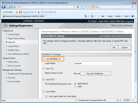

Enter the login name.
Up to 24 alphanumeric characters can be entered.
7
Select the [Use TTLS] or [Use PEAP] check box.
When using TTLS
Select the internal TTLS authentication method.
(1) Select [MSCHAPv2] or [PAP].

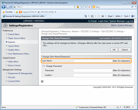

Click [Change User Name/Password...].
When using the log in name entered in Step 6 as the user name
Select the [Use Login Name as User Name] check box.
9
Enter user name.

11
Select the [Use IEEE802.1X] check box.
