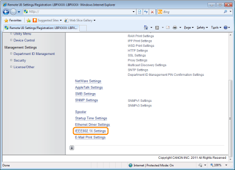

Click [IEEE802.1X Settings].

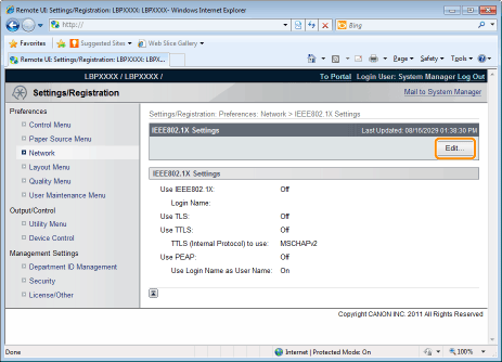

Click [Edit...].

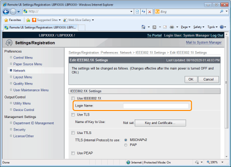

Enter the login name.
Up to 24 alphanumeric characters can be entered.

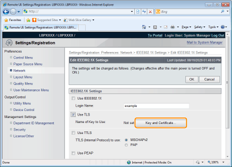

Click [Key and Certificate...].
9
Select the key to use, and then click [Default Key Settings].

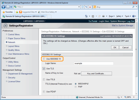

Select the [Use IEEE802.1X] check box.
 If a Message Appears
A message will be displayed if there is anything wrong with the settings. See Steps 6 to 9, and check the settings.
