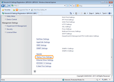

4
Click [Startup Time Settings].

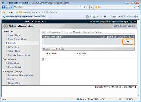

5
Click [Edit...].

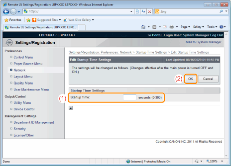

6
Specify the setting for startup time.
(1)
Enter the Startup Time from when you turn the printer ON to when the printer starts communication (0 to 300 seconds).
(2)
Click [OK].
