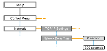

When configuring the startup waiting time using the printer's control panel, use the following menu hierarchy.
Pressing [ ] (Settings) displays the common Setup menu.
indicates that the procedure is performed by pressing [ ] or [  ] on the control panel.
indicates that the procedure is performed by pressing [OK] on the control panel.

1
Press [  ] (Settings), select [Network] using [ ] and [ ], and then press [OK].
When the message is displayed, press [OK].
You can specify the settings when the printer is either online (the Online indicator is on) or offline (the Online indicator is off).
2
Select [Network Delay Time] using [ ] and [ ], and then press [OK].
3
Specify the setting for startup waiting time using [ ] and [ ], and then press [OK].
Set a delay of between 0 and 300 seconds from the time the printer is turned ON until it begins communicating.
4
Perform a hard reset or restart the printer.
After performing a hard reset or restarting the printer, the settings are effective.
