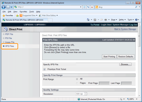

Start the Remote UI.
2
Select [XPS Files] from the [Direct Print] menu.

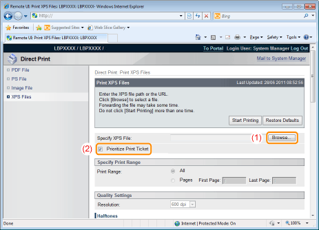

Specify [Specify XPS File].
(1)
Click [Browse...], select the file, and then click [Open...].
(2)
Clear the [Prioritize Print Ticket] check box.
If the [Prioritize Print Ticket] check box is selected, some items cannot be set via the Remote UI. To use all the print settings made via the Remote UI, clear the [Prioritize Print Ticket] check box.

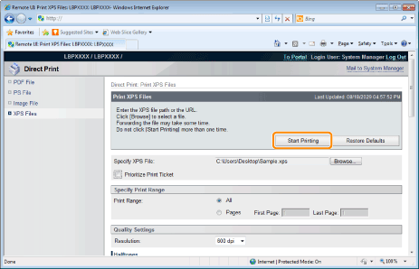

Click [Start Printing].
Do not keep clicking [Start Printing] while the file is transferring. Sometimes it takes time to transfer a file, but if you keep clicking during the transfer, a file failure may occur and it may be impossible to transfer it.
When the print job has finished sending, the display switches and the following message is displayed.
Press [To Job List] to check the print job that was sent.
