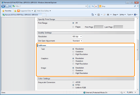

7
Specify the settings for [Halftones] as the following, as needed.
[Halftones]
Specify the halftone display method when printing.
You can set it for these data types: [Text], [Graphics] or [Image].
[Resolution]:
You can perform printing that combines smooth gradation with edge quality. It is suitable for printing graphics or graphs that use gradation.
[Gradation]:
You can print with a sharp gradation and well-balanced texture, contrasting light and shade, which is best suited for printing photo images.
[High Resolution]:
You can print in fine detail so that the edges of text data can be seen clearly. It is suitable for printing data containing text and fine lines.

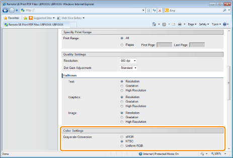

8
Specify the settings for [Color Settings] as the following, as needed.
[Grayscale Conversion]
Select the method for converting color print data to grayscale for printing.
This setting is for converting color data to B&W data.
[sRGB]:
It calculates the grayscale value using the sRGB standard color conversion method.
[NTSC]:
It calculates the grayscale value using the NTSC standard color conversion method.
[Uniform RGB]:
It takes the average value of the Red, Green and Blue color values as the grayscale value.
