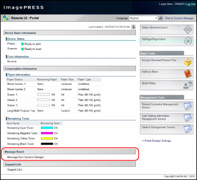

A Message Board Where the Message Appears on the Portal Page of the Remote UI
Messages are displayed at all times on the portal page of the Remote UI. This message board is best suited when you want to send messages to the Remote UI users.

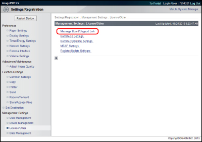

Displaying the Message Board
1.
Click [Settings/Registration] → select [License/Other] from the menu that appears under Management Settings → click [Message Board/Support Link].

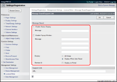

2.
Select the display settings and enter messages.
Enable Status Display:
Select to display the message board on the bottom of the touch panel display.
Message:
Enter messages displayed on the bottom of the touch panel display. You can enter up to 23 characters.
Enable Pop-up Window:
Select to display the message board on the touch panel display as a pop-up window.
If you select [Display on Portal], the message board is displayed on the portal page of the Remote UI.
Message:
Enter messages displayed on the touch panel display as a pop-up window, or on the portal page of the Remote UI. You can enter up to 23 characters per a line, and 4 lines are available for entering messages.
All Times:
Select to display the pop-up window messages at all times.
Display When Auto Reset:
Select to display the pop-up window messages when the main power is turned OFF and then turned back ON, or when the Auto Reset mode is activated.
Display on Portal:
Select to display the message board on the portal page of the Remote UI.
3.
Click [OK].
