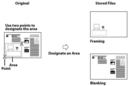

Designating a rectangular area with two points:
Designate two opposing points with the edit pen.
You can designate up to four different areas.

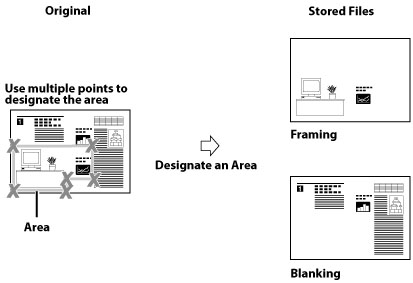

Designating an area with multiple points:
Press [Enter Multipoints] → specify the area with the edit pen.
After designating the last point, press [Set Multipoints].
You can designate up to 10 points.
IMPORTANT
If you select [Enter Multipoints], only one area can be designated at a time.
An area that is designated by selecting [Enter Multipoints], cannot be modified using - (numeric keys).

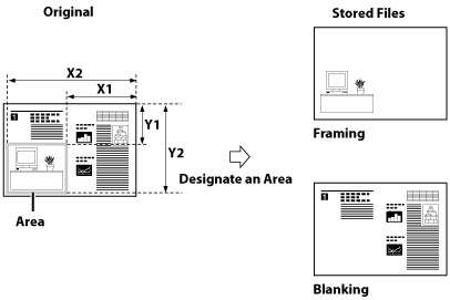

5.
Press [X1], [X2], [Y1], and [Y2] → use - (numeric keys) to specify the respective measurements.
[X1]:
The distance of the area's right border to the original's right edge.
[X2]:
The distance of the area's left border to the original's right edge.
[Y1]:
The distance of the area's top border to the original's top edge.
[Y2]:
The distance of the area's bottom border to the original's top edge.
You can designate up to four areas.
To change a value you entered, press [X1], [X2], [Y1], or [Y2] → enter the correct value using - (numeric keys).
To check the designated area, press [Check Area].
