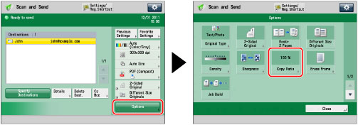

1.
Press (Main Menu) → [Scan and Send].
2.
Specify the destination → press [Options] → [Copy Ratio].
3.
Select the zoom ratio → press [OK] → [Close].

1.
2.
3.
Use [-] and [+] to specify the zoom ratio → press [OK] → [Close].

1.
2.
3.
Press [Auto] → select the original size → press [OK].
4.
Press [Close].
