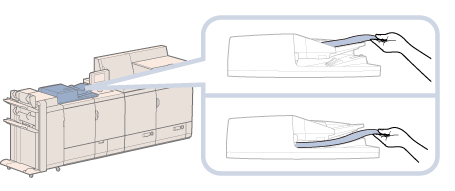

If you want to select a nonstandard scan size longer than 11" x 17":
Press [Long Original].
If you want to scan long originals whose width is 17" to 24 7/8" (432 mm to 630 mm), press [Long Original].
IMPORTANT
If you scan long originals from the feeder, the Auxiliary Original Output Tray should not be pulled out in order to prevent scanned originals from creasing.
In this case, support originals by hand when feeding and outputting paper.

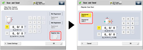

Registering the Scan Size
1.
Press (Main Menu) → [Scan and Send] → press the scan size button.
2.
Press [Custom].
3.
Press [Register Size] → [Registered Size 1] or [Registered Size 2].
4.
Press [X] and [Y] → enter the scan size in mm → press [OK].
5.
Press [Cancel Settings] → [Cancel].
