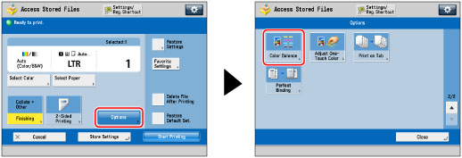

Press [Change Print Settings].
4.
Press [Options] → [Color Balance].
