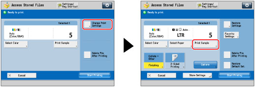

Press [Change Print Settings] → [Print Sample].

Select the pages to print as a sample.
If you select [All Pages]:
If you select [Specified Pages]:
Press [All Pages].
Press [OK].
Press [Specified Pages].
Press [First Page] and [Last Page] → press [-] or [+] to set their respective page numbers.
Press [OK].
5.
Press [Start Printing].
