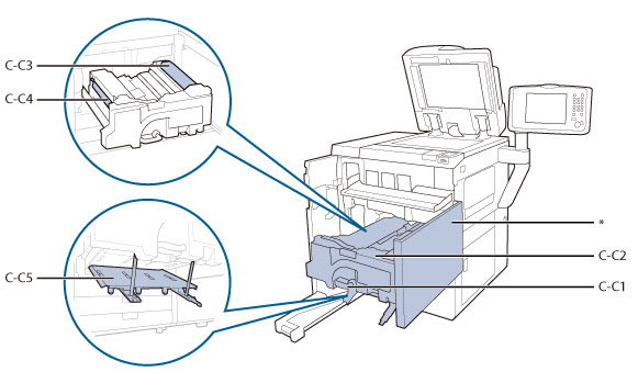

This section describes how to clear a paper jam which occurs in the fixing transport unit of the machine. The location of the fixing transport unit of the machine is indicated in the following illustration.
The following illustration indicates the location of the paper jam. Please refer to it to remove the jammed paper.

Open the front cover of the main unit, and turn the lever (C-C1) in the direction of the arrow (counterclockwise).
1. Open the front cover of the main unit.
2.Turn the lever (C-C1) in the direction of the arrow (counterclockwise).
3.
Remove any jammed paper from the fixing transport unit (C-C2).
1.Grip the lever (C-C1), and pull out the fixing transport unit (C-C2).
2.Remove any jammed paper from the fixing transport unit (C-C2).
4.
Remove any jammed paper from the guide (C-C3).
1. Open the guide (C-C3).
2. Remove any jammed paper.
3. Close the guide (C-C3).

Open the inner output unit, and remove any jammed paper.
1.Open the guide (C-C4).
2.Remove any jammed paper.
3. Close the guide (C-C4).
7.
Remove any jammed paper from the guide (C-C5).
1. Open the guide (C-C5), holding by the green tab.
3. Close the guide (C-C5).

Gently push the fixing transport unit (C-C2) back into its original position, and close the front cover of the main unit.
1. Gently push the fixing transport unit (C-C2) back into its original position.
