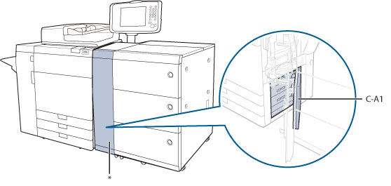

The following illustration indicates the location of the paper jam. Please refer to it to remove the jammed paper.
* Right Cover
Follow the procedure described below, while referring to the location of the paper jam and the directions that appear on the touch panel display, to remove the jammed paper.

2.
Open the front cover of the Multi-drawer Paper Deck-B1.
3.
Remove any jammed paper from the right cover (C-A1) of the main unit.
1. Open the right cover (C-A1) of the main unit.
2. Remove any jammed paper.
4.
Close the right cover (C-A1) of the machine.
