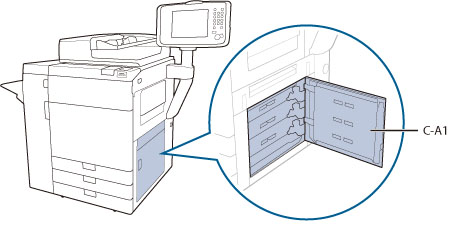

This section describes how to clear a paper jam which occurs in the right cover of the machine. The location of the right cover of the machine is indicated in the following illustration.
When the POD Deck Lite-B1 is attached, move the POD Deck Lite-B1 away from the main unit beforehand.
The following illustration indicates the location of the paper jam. Please refer to it to remove the jammed paper.
Follow the procedure described below, while referring to the location of the paper jam and the directions that appear on the touch panel display, to remove the jammed paper.

Remove any jammed paper from the right cover (C-A1) of the main unit.
1. Open the right cover (C-A1) of the main unit.
2. Remove any jammed paper.
3.
Gently close the right cover (C-A1) of the main unit until it clicks into place in the closed position.
