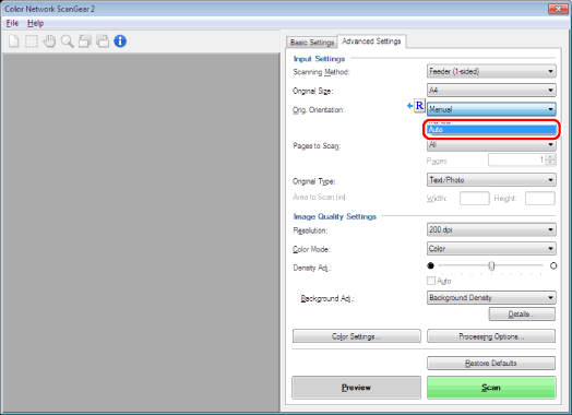

When scanning from the feeder, you can set Network ScanGear to display the document in its correct orientation on the computer monitor.
1.
Switch the scanner online → load the originals into the feeder → start Color Network ScanGear 2 from the application.
For details, see "Scanning from an Application."
2.
In the [Advanced Settings] tab, set [Orig. Orientation].
[Auto]:
[Manual]:
[Auto]:
Select [Auto].
During scanning, the orientation of the original is detected automatically, and the scanned image is rotated if necessary, so that it is displayed correctly on the computer screen.
The [Auto] function is only available in 32-bit versions.
[Manual]:
Select [Manual] → click [Settings].
Select the orientation of the originals to be loaded into the feeder for [Feeding Direction].
For 2-sided originals, also set [2-Sided Original Opening Type] to indicate the relation between the front and back sides of a 2-sided original.
Click [OK].
