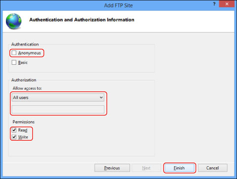

If you are using Windows 8/Server 2012:
Right-click the [Sites] icon → click [Add FTP Site].
Enter the appropriate site information in the [Add FTP Site] dialog box → click [Next].
Specify the binding and SSL settings respectively → click [Next].
Deselect [Anonymous] for <Authentication>.
Set the user/group whom you want to give access to the FTP site in <Allow access to>.
Select both [Read] and [Write] for <Permissions> → click [Finish].
