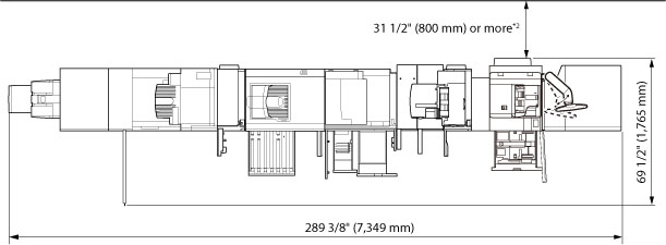

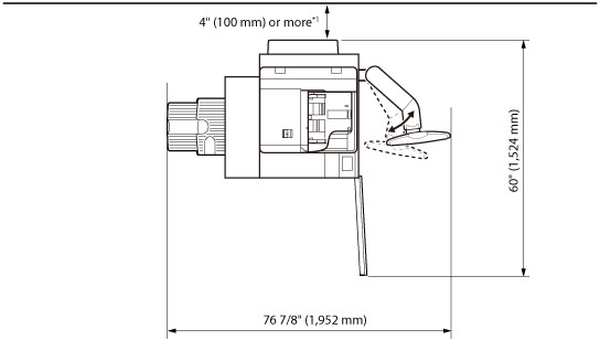

Provide Adequate Installation Space
Provide enough space on each side of the machine for unrestricted operation.
When the Output Tray-A1, Duplex Color Image Reader Unit-H1, and Upright Control Panel-D1 are attached:
*1 Make sure to provide at least 31 1/2" (800 mm) of space if you attach one or more of the following: Paper Folding Unit-F1, Professional Puncher-B1, Document Insertion Unit-M1, Multi-drawer Paper Deck-B1, Perfect Binder-D1, or High Capacity Stacker-G1.
When the Two-Knife Booklet Trimmer-A1, Booklet Trimmer-D1, Saddle Finisher-AM2, Paper Folding Unit-F1, High Capacity Stacker-G1, Perfect Binder-D1, Professional Puncher Integration Unit-C1, Professional Puncher-B1, Document Insertion Unit-M1, Duplex Color Image Reader Unit-H1, Upright Control Panel-D1, and Multi-drawer Paper Deck-B1 are attached.
*2 Make sure to provide at least 4" (100 mm) of space if none of the Paper Folding Unit-F1, Professional Puncher-B1, Document Insertion Unit-M1, Multi-drawer Paper Deck-B1, Perfect Binder-D1, or High Capacity Stacker-G1 is attached.
