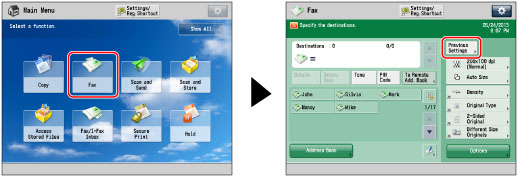

You can recall the three most recent destinations, scan settings, or send settings.
1.
Press (Main Menu) → [Fax] → [Previous Settings].
2.
Select the settings to recall → press [OK].
You can change the settings for a recalled send job.
If there are multiple destinations stored in one log, the order of the destinations shown in the list may not correspond to the order in which they were set.
