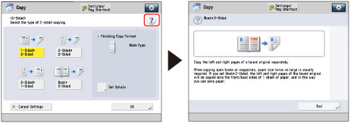

Displaying a Help Screen
Any time appears on the touch panel display, you can check a detailed explanation of the function and its settings.
