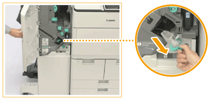

      Open the front cover of the finisher.
      2
      Pull out the staple case from the stapler unit.
      Hold the green tab of the staple case, and pull it out straight toward you.
