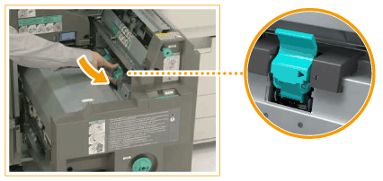

      Pull out the two staple cases.
      4
      Hold both sides of the staple case, and lower the bracket.
      5
      Remove all the jammed and protruding staples from the staple case.
      6
      Return the bracket on the staple case to its original position.
