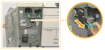

      Open the front cover of the finisher.
      3
      Pull out the staple case from the stapler unit.
      Hold the green lever of the staple case, and pull it out straight toward you.
