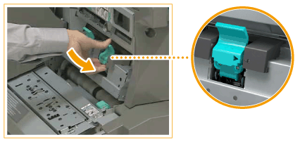

      Pull out the two staple cases.
      4
      Hold both sides of the staple case, and lower the bracket.
      5
      Remove all the jammed and protruding staples from the staple case.
      6
      Return the bracket on the staple case to its original position.
      7
      Insert the two staple cases into the saddle stitcher unit.
      Make sure that the staple cases are inserted so that the setting position marks are aligned as shown in the illustration above.
