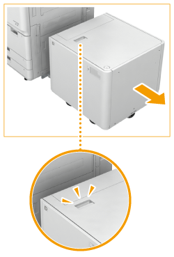

      Separate the paper deck unit from the main unit.
      POD Deck Lite-C1
      Paper Deck Unit-E1

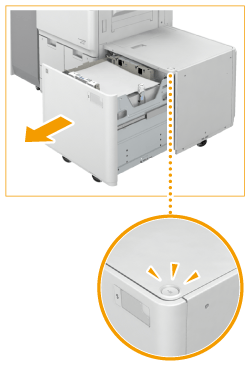

      2
      Remove the jammed paper from the side of the paper deck unit.
      POD Deck Lite-C1
      Paper Deck Unit-E1

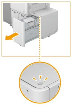

      4
      Open the paper deck.
      POD Deck Lite-C1
      Paper Deck Unit-E1
      NOTE:
      You may not be able to open the paper deck when the machine is in sleep mode. In this case, exit the machine from sleep mode, and press the open button. Entering Sleep Mode
      5
      Remove the jammed paper.
      POD Deck Lite-C1
      Paper Deck Unit-E1
      Make sure to check thoroughly as paper jams sometimes occur in places difficult to find.
