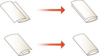

      You can adjust the folding positions of the paper, such as when folding a paper in half using the optional booklet finisher, or when performing Z-fold or C-fold using the optional paper folding unit.

      Adjust the folding position.
