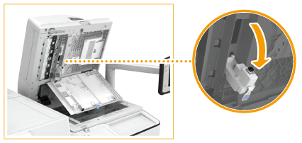

      3
      Open the stamp cover.
      4
      Insert the stamp cartridge.
      Use tweezers to remove the old stamp cartridge.
      Use tweezers to insert a new stamp cartridge.
      IMPORTANT:
      Push in the new stamp cartridge until it clicks. If the stamp surface of a stamp cartridge is protruding, it may cause a paper jam.
