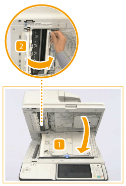

      Open the scanning area cover, and then open the inside cover.
      Pull the lever above the feeder, and open the scanning area cover.
      Gently open the scanning area cover so as not to damage the platen glass.
      Hold the tab above the inside cover, and open the inside cover in the direction of the arrow.

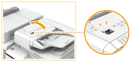

      Pull the lever and open the feeder cover.

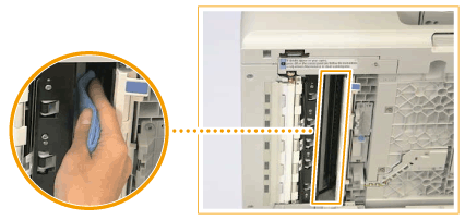

      Clean the rollers (a total of five places) inside the feeder cover.
