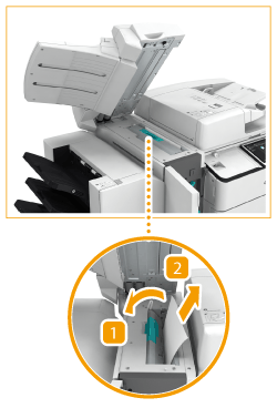

      Open the front cover and the document insertion unit.
      Open the front cover.
      Open the document insertion unit.
      5
      Remove the jammed paper from the delivery unit.
      Open the delivery unit.
      Remove the jammed paper.
      Close the delivery unit.
