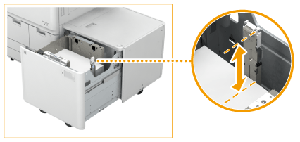

      Load the paper below the rollers of the rear edge retainer.
      When loading paper, make sure that the height of the paper stack does not exceed 13/16" (20 mm). If the height of the paper stack exceeds 13/16" (20 mm), the edges of the paper stack may become curled or creased, and poor print quality may result.

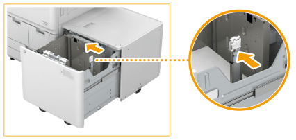

      3
      Slide the rear edge retainer until it does not catch on the paper to set.
      The rear edge retainer slides by holding.

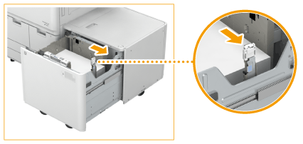

      8
      Slide the rear edge retainer to align it with the desired paper size, as shown below.
      IMPORTANT:
      If the rear edge retainer is not aligned properly, paper may become jammed, the quality of the image may be degraded, or the inside of the machine may become dirty. Make sure to load paper with the rear edge retainer properly aligned with the paper size marks on the top and base of the paper deck.
