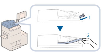

If you want to scan long originals whose width is 17" to 24 7/8" (432 mm to 630 mm), press [Long Original].
IMPORTANT
If you scan long originals from the feeder, the Auxiliary Original Output Tray should not be pulled out in order to prevent scanned originals from creasing. In this case, support outputting originals with your hands.

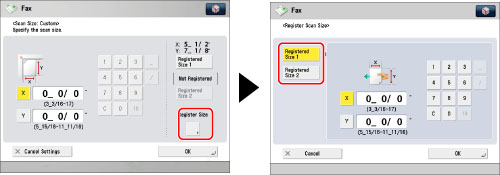

Registering the Scan Size
1.
Press [Fax] → press the scan size button.
2.
Press [Custom].
3.
Press [Register Size] → [Registered Size 1] or [Registered Size 2].
4.
Press [X] and [Y] → enter the scan size using the numeric keys → press [OK].
5.
Press [Cancel Settings] → [Cancel].
