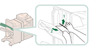

1.
Remove any jammed paper in the output part.
1. Lift up the output slot.
2. Remove any jammed paper that is visible.
If you cannot see any paper, check whether there is any jammed paper in the output area.
If a paper jam occurs when you are printing in the Staple mode, do not remove the output sheets that are waiting to be stapled. (Printing and stapling resume after you clear the paper jam.)
