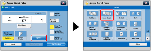

1.
Press [Access Stored Files] → [Mail Box].
2.
Select the desired Mail Box → select the desired file → press [Print].
3.
Press [Change Print Settings] → [Merge Files and Print].
4.
Press [Options] → [Job Separator].
5.
Select the paper source to use for the job separator sheets → press [OK] → [Close].
