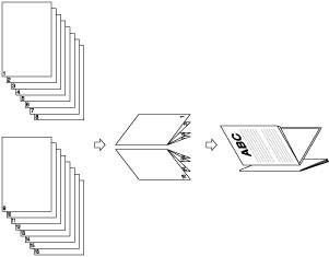

Divided Booklet
This mode enables you to make a large document with many pages into a divided booklet.

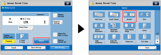

Press [Access Stored Files] → [Mail Box].
2.
Select the desired Mail Box → select the desired file → press [Print].
3.
Press [Change Print Settings].
4.
Press [Options] → [Booklet].
5.
Specify the booklet print settings.
