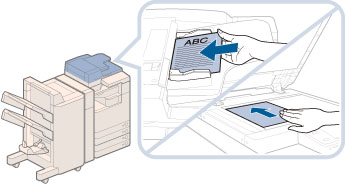

1.
Place your originals.
If the automatically selected paper size is different from the paper size you want, press [Select Paper] → select the required paper size. (See "Paper Selection.")
For instructions on placing your originals, see "Placing Originals."
If [Auto Collate] is set to 'On', the Collate or Offset Collate mode is automatically set when you place your originals in the feeder. (See "Enabling Auto Collating.")
