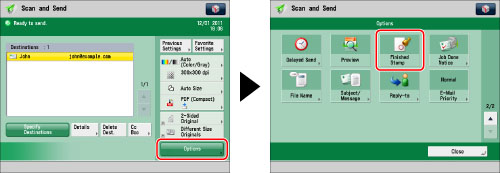

1.
Press [Scan and Send].
2.
Specify the destination → press [Options] → [Finished Stamp].
3.
Press [Close].
