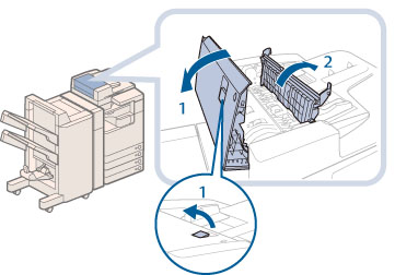

1.
Open the covers.
1. Pull the lever → open the feeder cover.
2. Open the inner cover, holding it by its tab.

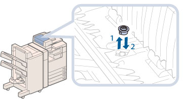

2.
Load the stamp cartridge.
1. Remove the old stamp cartridge, using tweezers.
2. Push in the new stamp cartridge until it clicks, using tweezers.
IMPORTANT
Make sure that the stamp cartridge is not protruding from the surface.
Insert the stamp cartridge properly, or paper jams may occur.

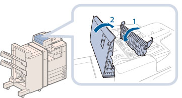

3.
Close the covers.
1. Close the inner cover.
2. Close the feeder cover.
CAUTION
When closing the covers, be careful not to get your fingers caught, as this may result in personal injury.
