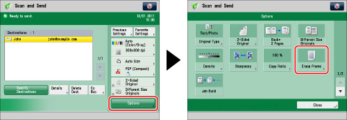

1.
Press [Scan and Send].
2.
Specify the destination → press [Options] → [Erase Frame].
3.
Press [Erase Original Frame].
