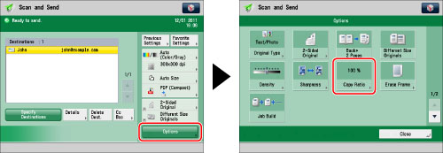

1.
Press [Scan and Send].
2.
Specify the destination → press [Options] → [Copy Ratio].
3.
Select the zoom ratio → press [OK] → [Close].

1.
2.
3.
Use [-] and [+] to specify the zoom ratio → press [OK] → [Close].

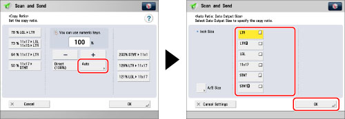

Auto Zoom
You can automatically enlarge or reduce an original to a specified paper size. The same zoom ratio is used for the horizontal and vertical axes.
1.
2.
3.
Press [Auto] → select the original size → press [OK].
4.
Press [Close].
IMPORTANT
If you want to send with [Auto], set the resolution to 300 x 300 dpi or 600 x 600 dpi.
The maximum size of an image that you can send at 600 x 600 dpi resolution is 11" x 17". If the image exceeds this size, it may be cut off.
If you select [Long Original] as the scan size, you can only send documents at a zoom ratio of 100%.
If you set PDF (Trace & Smooth), PDF (Compact), PDF (OCR), XPS (Compact), XPS (OCR), or OOXML as the file format, you can only send at a zoom ratio of [Direct (100%)] or [Auto].
To return the ratio to 100%, press [Direct (100%)].
