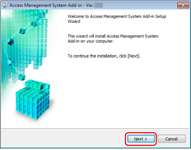

Double-click the Setup.exe file for the AMS Printer Driver Add-in.
The AMS Printer Driver Add-in setup wizard starts.
5.
Click [Next].

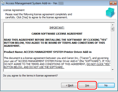

6.
Confirm the displayed information → click [Yes].

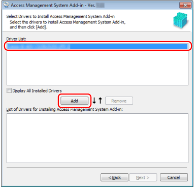

7.
Select the driver to install the AMS Printer Driver Add-in to from the [Driver List] → click [Add].
When a desired printer driver is not displayed or a printer driver exists but does not have a printer icon (for the server of a terminal service, etc.), select [Display All Installed Drivers].

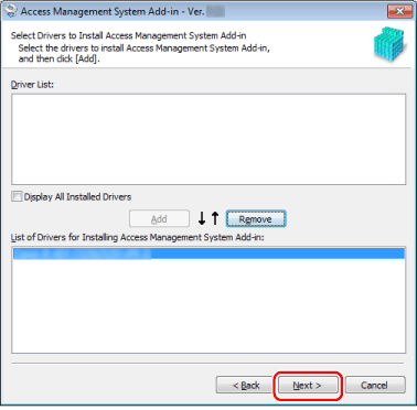

8.
Click [Next].
9.

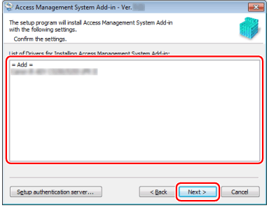

Confirm that the appropriate driver names are displayed in [List of Drivers for Installing Access Management System Add-in] → click [Next].

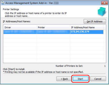

10.
Click [Yes] when the message confirming whether you want to retrieve the device (printer) information is displayed.
If you click [No], the device information is not retrieved. Enter the IP address or host name of the printer on the next screen.
11.
Click [Start].
If you clicked [No] in the previous page, click the [IP Address/Host Name] field for that driver → enter the IP address or host name of the device.
If [Enter IP Address/Host Name] is displayed in the [IP Address/Host Name] field, click [Get IP Address]. If the IP address cannot be retrieved, click the [IP Address/Host Name] field for that driver → enter the IP address or host name of the device.
If multiple printers that use the same printer driver are connected to the network, all of those printers are displayed in [IP Addresses/Host Names].

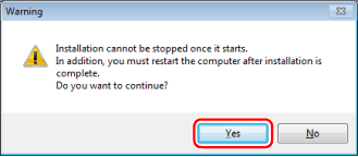

12.
Click [Yes] when the message confirming whether you want to start installing is displayed.
The AMS Printer Driver Add-in is installed.

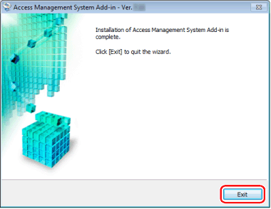

13.
Click [Exit].

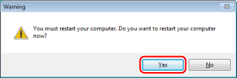

14.
Click [Yes] in the displayed dialog box.
The computer will be restarted and the installation completes.
