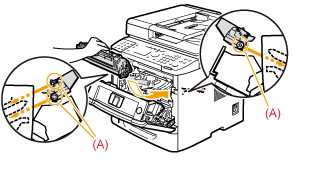

See "Attention (Replacing the Toner Cartridge)" in advance.
Keep the protective bag. You will need them when you remove the toner cartridge for printer maintenance or other purposes.
IMPORTANT
Precautions when pulling out the sealing tape
Do not pull the sealing tape at an angle or up and down. If the tape breaks, it may not be pulled out completely.
![]() If the sealing tape is still hanging outside the toner cartridge, pull it out completely. If the tape remains inside the toner cartridge, it may cause poor print quality. If you are using the Fax, please note that you can only print the received data once, because the received data is deleted once it is printed.
Dispose of the sealing tape according to local regulations.
If you cannot close the front coverMake sure that the toner cartridge is installed correctly. Do not try to forcefully close the toner cover, as this may damage the machine.
